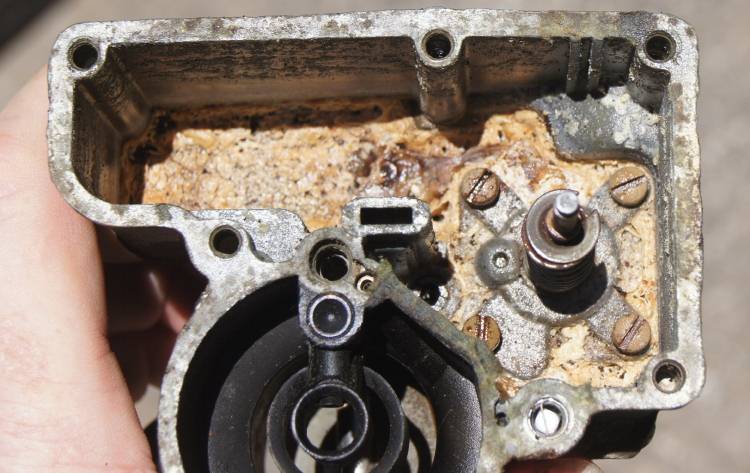

This summer the truck would not start and run with fresh gas in the tank. It would sputter and run briefly on Starting fluid. And would run a little longer on several ounces of raw gas poured down the throat of the carb. Indications were that the carb was clogged.
I removed the carb and discovered this mess.
Built up gunk from the wonderful E-10 which apparently has absorbed the moisture in the air and left it in the carb. I guess when you run a Carter out of fuel there is still about 1/2 inch in the bottom.
Not much to do except soak the carb and rebuild. I have ordered a kit and it will be running by the weekend.
Note to all. Drain your carbs before short term storage.
