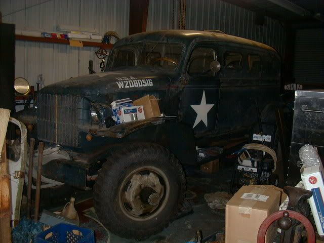

I bought this set new in 1985. They are AVM's from Brazil - no longer made. They were a little over $300 back then. They have been great and woth every penny IMO. Cold 90 wt gear oil really eats up power at highway speeds.
They do stick out some but not as far as the duals do. I also had a set of Duomatics on my M6 Bomb truck and really liked them too.
