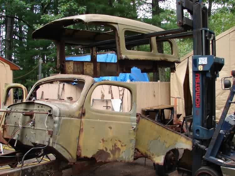

I am lucky enough to have a small fork lift to do that type of dirty work for me. An invaluable tool...another piece of junk in the yard that the neighbors love.
