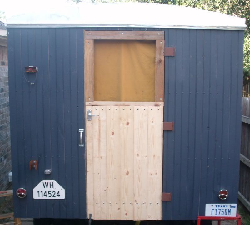

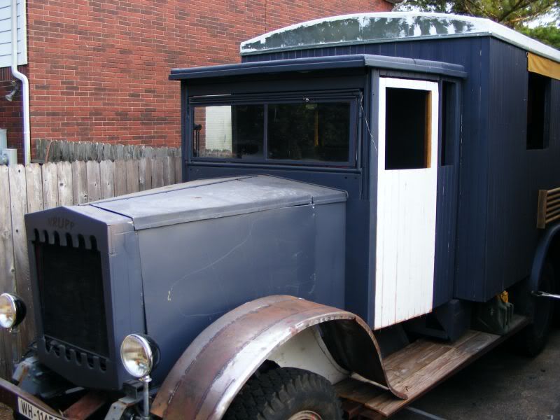

Thanks John. I set it in slightly from the lip but not touching the roller bearing. I compromised and 1/2 filled the hub.
The truck is coming along. Mostly boring mechanical work of late. I finally gave up on trying to fix the original Hydrovac and went with one of Bob's new post-war style. I wish I had heeded the advice on here about starting with the mechanicals before building the rest of the truck. Then they would have been out of the way and I could do the fun stuff.
100 Degree temps and funds being diverted to acquiring original radios to go in the back of the truck has slowed progress a little. There is still some major construction and a LOT of flashing to complete.
