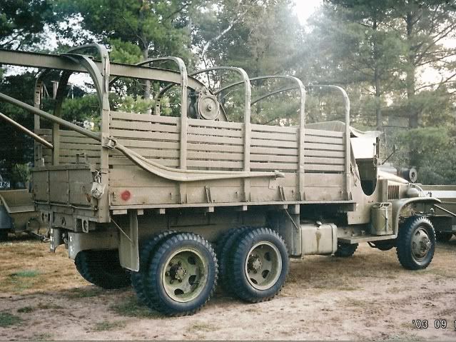

This is an old thread, but I remembered a Tow Bar mounting and found my photos. This is on a wood body and the truck has the Set Number 7 equipment installed.
Hope this gives you some ideas.
I purchased one of these tow bars last June and hope to get it painted and mounted similar to this. On the 4 Ton Diamond T wreckers the tow bar is also on the right side but is mounted with the curved side at the top.
In these photo's you can see the rear bracket has a verticle pin that the tow bar is lowered onto. On the front there is a short verticle tube about the size of the inside diam of the lunette. The bar is retained with a top piece of channel iron about 6 inches long and it has a large safety pin fitted with a small chain so you don't loose the retaining bar.
