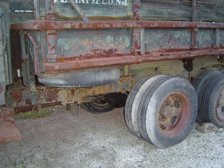

Re: Dump truck
retro-roco wrote:Are those type of stake pockets typical of CCKW dump bodies? It's interesting how they are just a top and bottom strap, rather than a single piece pocket...
I have seen "tippers" with pockets both ways. Below is a picture of a clapped out tipper in NJ that I looked at several years ago. From the inspection it certainly looked original and except for the rust was not all beat up
abn CCKW
Post by abn CCKW »
as far as I know the Dump body has only the strap top and bottom
diffcult to see in the photo of mine but its the same as Arthur m. has
