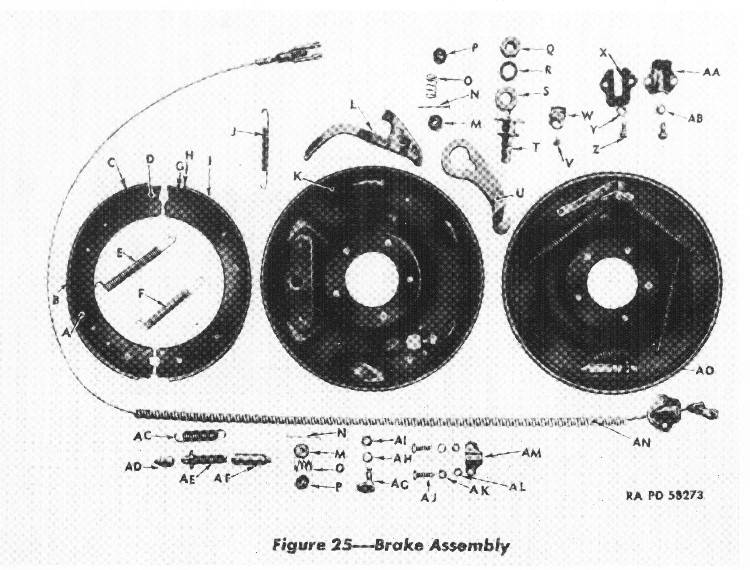

I went to move my Ben Hur cargo trailer the other day with the backhoe and come to find out, one wheel will not go forward
I have to assume that the brake return spring is broken inside. It will rotate backwards OK.
The CCKWs also exhibit this "feature" when a return spring breaks. The shoe(s) move outward and act like a one way clutch.
QUESTION: Seein' where I will have to fix this in the spring, who carries replacements (or something close) for that spring?
Thanks
