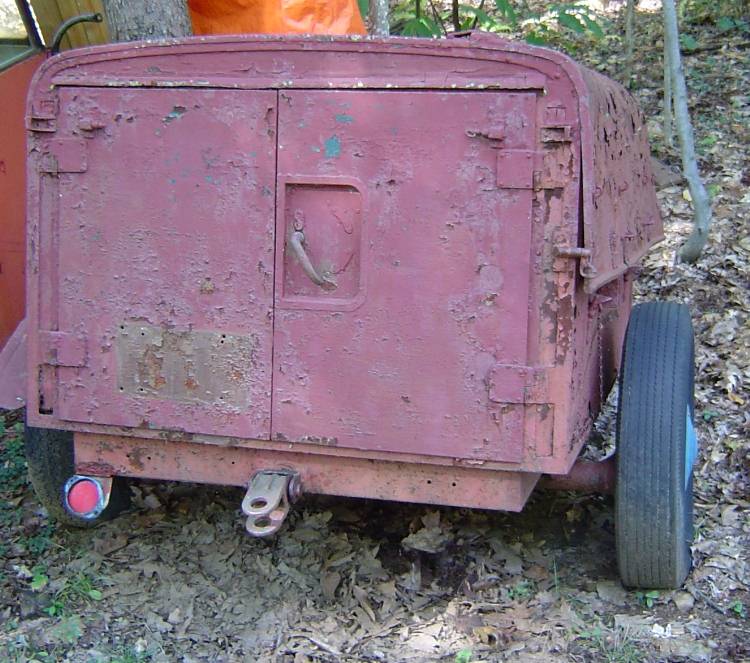

I have been given the opportunity to buy this trailer and need help identifying it.
The seller states that it is WWII and was brought back to the US by a Army Officer who was in the post war occupation force. He packed all his personal belongings into the back and shipped his stuff home that way.
The trailer is "Allegedly" a Mercedes (or Damlier)Benz trailer. Looks like 1/2 ton. It rides on a torsion bar. Has 40's era Mercedes wheels with hub caps. The trailers base coat is a dark blue green with hints of desert tan or camo light green under the red paint. It has openning front and rear doors and one side of the roof panel opens for access from above. It is sheet metal stretched inside a 3/4 inch angle iron super structure. There is no frame like on a WWII Ben hur. The towing bar runs from the the front hitch to the rear pintel.
The floor is 3/4' Oak slats It has no brakes. Where the sheet metal sides meet the bottom frame is rusted through all the way around and the sides will need replacing.
Any body know what this is? Especially our European friends. What is it worth?
Need help Identifying WWII German Trailer...Please!
This is a neat trailer. It is somewhat over designed for what it is but having worked for a German Company that is nothing I have not seen before.

Check out the seriousness of the handles and latches, also the reflector is mounted on a hinge so it will move out of the way if struck. Note the rear hitch as the front has to be the same to fit into this.

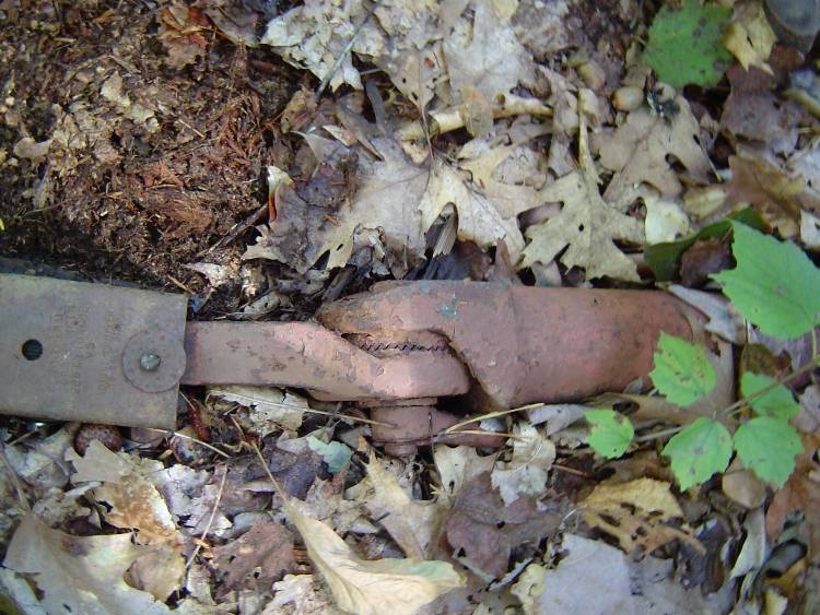

This is a picture of the front hitch arm. A ball type hitch has been installed to facilitate towing by a modern vehicle. I believe under the hitch coupler is a verticle arm which has a hole drilled in it to accept a pin.. Not the ratcheted positioning for level transport..

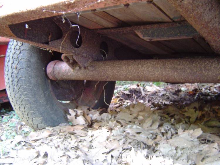

This is the underneath of the trailer...Torsion bar and moderate frame. Oak planks are the bottom of the trailer....they look original and are 95% intact.
I doubt many of these made it to the USA. Any of our CCKW friends from Europe have any info?
Neat little trailer....I wonder what it was used for.
