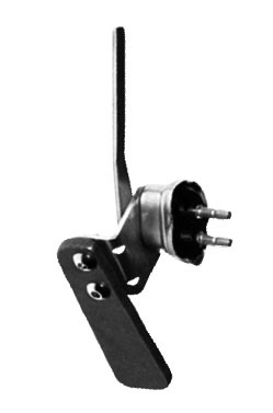

if you are talking about the stop light switch, you can rig up a more modern switch activation system, as detailed by another poster.
i did this, search for the thread if u are interested ( i just copied the instructions)
CCKW 353 w/winch
Indeed, I use a lever action switch whic is much better. The minute you touch the pedal, the brake light(s) come one
1957 Chev pick up switch. Jim Carter has them if you cannot find them locally. They are a pain to put in the 1st time. You really need 2 people
NAPA carries them
But you had better ask for a brake lite switch :lol:

Neil,
This summer I did the master in mine too. Moved the old brake light switch over but it did not work well.
As per our famous (or infamous) Dr. Deuce I replaced it with the mechanical switch. Found at the local parts store for $17. I had to remove the floor to mount it properly and some minor bending of the arm was involved.
Now the lights go on instantly upon touching the pedal.
This was another great safety upgrade.
One of the problems with the original is that it is a low pressure switch. Think about it. It is before the booster. There never is full pressure there. So if you replace the switch with a modern one made for the "other side" and hight pressure, the brake lights will never come on.
One note: You need to make sure you route the wires and secure them such that they don't get caught up in the pedals or linkages.
