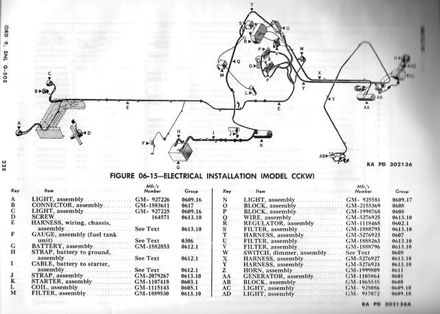

I have a problem. I removed the filters from my firewall (CCKW) to clean and paint everything, now i dont know what goes where. The two i am having trouble with , one is stamped 30V 10 AMPS, the other 30V 55 AMPS. One goes over the voltage regulator , the other feeds the distributor.One has a p/n on it but i don't have an ORD9 manual.Any help will be appreciated.

The 55 Amp one would be for the regulator to ammeter line

Here is the Ord 9 Diagram and part numbers

Thanks guys i greatly appreciate your help ! I knew you guys would come through !
